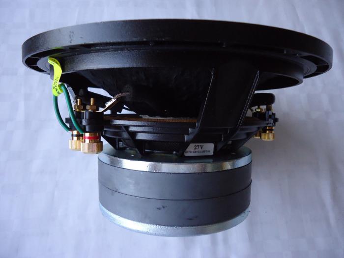

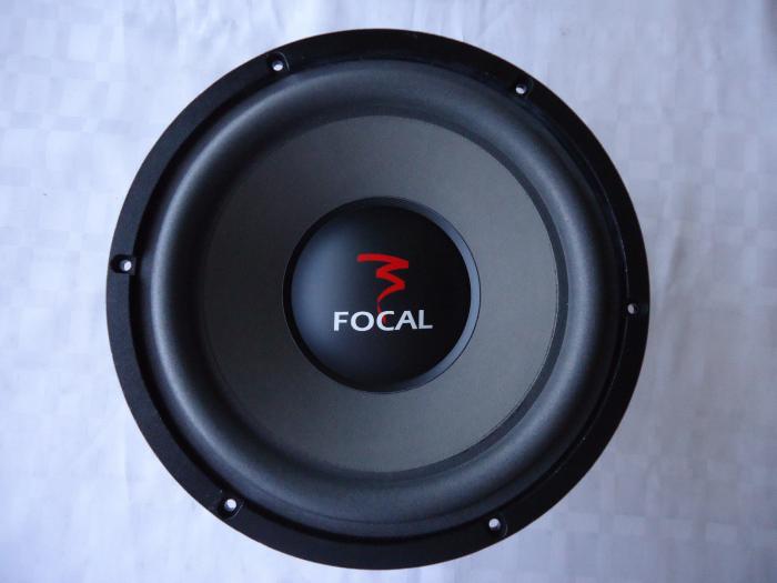

Vie niekto poradit aka bi maka bit ozvucnica na Focal polyglass 27V neviem to najst len toto MPN 27V
UPC 3544055751267
Key Features
Car Speaker Function Subwoofer
Size 11"
Type Component
Elements 1-Way
Powered Non-Powered
RMS Power 250 W
Technical Features
Min Frequency Response 35 Hz
Max Frequency Response 1 kHz
Sensitivity 89.5 dB
Peak Power Handling 500 watt
Mounting
Top Mounting Depth 5.2 in.
Enclosure Non-Enclosed
Components
Woofer Material Poly / Plastic
Magnet Material Neodymium
foto k příspěvku  od domimezo
o 30.01.2014, 22:08 | domimezo
